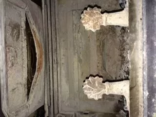

My Dutchwest Non-Cat 2478 (bought in 2006) has issues, the most pressing being the severely warped top plate (see attachment - note the smiley faced hole where the damper meets the inner top! It's even cracked slightly at the back corners). Also, I'm pretty sure there isn't much left of the "Fountain assembly", and it needs new "Right End Insulation" and "Right End Refractory".

I think if nothing else I have to replace the inner top because I can't shut the stove down properly and am going through too much wood. For the right end insulation and refractory, I'm not too worried and am tempted not to spend $100 for those parts.
For the fountain assembly, I'm just not sure... How critical is this part? I don't think it held up much after the first year or two. I assume this helps with the stove's efficient burn, perhaps providing a means for the secondary combustion air to be heated up, slowed down, dispersed etc. Should I spend the $ to replace the fountain assembly, or is it just not worth it? I don't think I've noticed a big difference in the stove when the fountain was fresh and new, and now, but it's hard to tell. I know from hearth.com that others have had trouble with the DW stoves.
So a total of about $500 - I could just buy a new stove. But I'm tempted to just replace the inner top and just forget the rest for now. What should I do? I'm concerned that because of the severe warping I might have a hard time getting the stove apart and fit back together with a new inner top. We're also into wood burning season, so I don't want the stove to be out of commission for long (shame on me for not taking care of this in the summer).

I'm afraid some of the repair advice you may hear here is "throw that stove away" because whatever money you sink into it now will be followed by more later, perhaps to no good end. I would not burn it without that new top, but personally would be inclined to get a new stove and/or turn this one either into a "project" stove with a complete rebuild or into a $0 "smoke dragon" stove, to be burned as backup or in a shop without thought to secondary combustion or efficiency.
The fountain assembly is critical, not just helpful, with the stove's efficient burn. Unless that and the other refractory are largely intact and in place, don't count on getting good secondary combustion. That doesn't mean you won't get plenty of heat output, but just that you will essentially be burning what amounts to a pre-EPA smoke dragon rather than a highly efficient EPA unit..
The ashpan door shouldn't be a problem over a minute or two AT THE MOST. But if you forget about it, with a full load... well, forget about it, that's an overfire. These downdraft stoves though are also easily overfired in the normal course of operation with strong draft conditions. I have seen the back of my stove rise above 800f with primary air shut, and the Harmans are generally more well-behaved than the Lopi Leyden or sone VC "NeverBurn" models, which some might term "OverBurn" after watching the back of their stove start to glow.
Tough call, but sometimes better to cut your losses... you could probably pick up a slightly-used NC30 for less than the parts cost for your VC.

Just a follow up - I decided to spend $115 only and buy a replacement inner top. While a new stove would be great, I can't really afford it right now. Also, I didn't want to shell out for a new fountain assembly and the right side refactory that I need. I replaced the inner top over the weekend. It was really easy getting the stove apart. Just 4 bolts and the outer and inner top came right off. I feared that the warping would have impacted other parts on the stove but it was not the case. It was a pretty easy job. I also cleaned the chimney and replaced all the gaskets, so the entire job took the better part of a Saturday.
The worst part of the job though was the darn fountain assembly. It had a 2 inch wide hole in its top. I tried to stick a vacuum hose down thru the hole to clean out the ash that had formed inside the assembly. Of course this only made the hole bigger... I'd put a broken piece of fire brick over the hole to plug it, and as I tried to replug it when done, the hole just kept getting bigger. So I ended up having to keep breaking more bricks to come up with pieces to cover the ever-growing hole. What a pain. That fountain assembly is just falling apart. I wonder if the newer replacement parts may consist of a more durable material. I assume not. I'm kind of going against @branchburner's advice here, which I really do appreciate. But being stubborn I'm half inclined to buy that part.
The stove got us through last winter OK, and with a functioning damper now, I suspect that we'll do even better this year. But I do realize I am completely sub-optimal with the useless fountain assembly. I just can't believe how fragile that thing is.
