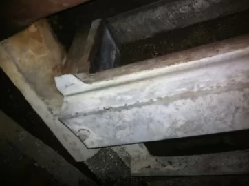

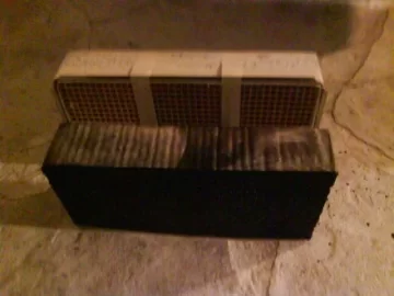

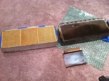

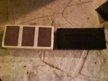

Take a look at the pics. The new cat has a metal piece around it while the old cat doesn't. In the pic with the cats standing on there sides you can see the metal tabs on the right and left of the new cat. Make sure that metal piece isn't still in the stove.

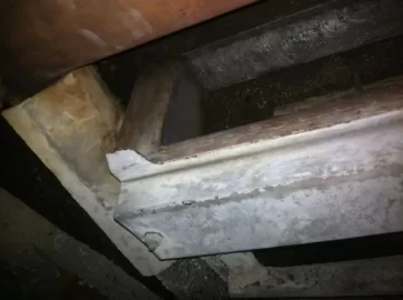

There are two metal tabs in the stove on the right and left that ware not attached to the stove. you can see it in the picture. The cat will go in without these. its ok to take these out?

you can see the to side metal tabs. the only way this cat is going inthere is without them.

I think those other tabs you took out are spacers and should be left in the stove.
