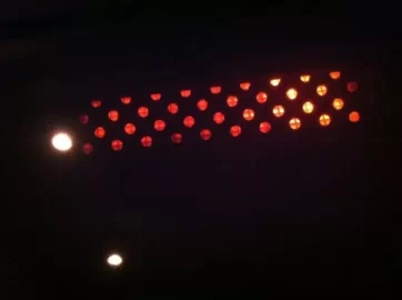

heres a nice picture.

Glad ya got it in and working. When I changed mine it wasn't hard at all. It just slide right in.

That looks like the way it is supposed to look.
Good job
