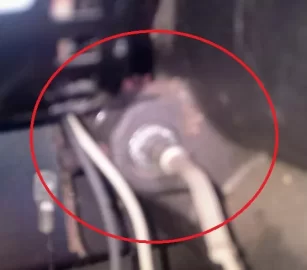

When accessing the igniter from the back of the unit there appears to be a 5/16" set screw to the left of the existing igniter/collar but after loosening it, the "old" igniter doesn't seem to want to move. I'm hesitant to use excessive force to remove it by really reefing on it or by using pliers or locking pliers. My fear is that excessive enthusiasm could break off the igniter leaving a big chunk of it behind in the cast iron where the collar buts up on the igniter hole. And THEN how to get it out?
Wanting to avoid that particular problem, does anyone have advice for easing the old igniter out (if "easing" is possible)?
Acknowledging that I can't take a cell phone picture to save my life, I'm attaching an image of the back of the igniter/collar and set screw (sorry for the reaaaaally bad image quality).

If you plan on using the stove daily you will be doing gaskets and cleanings regularly. Englander stoves are temperamental to cleanliness, they do not perform well if dirty. If it is needed you can remove the burn pot and plate and use a drift and tap the igniter out from the front. But you will need a pot gasket (or 5 keep them on hand)
This is the big brother to your stove but its the same procedure
It's probably corroded in place. Use a screwdriver and hammer to tap on it and it should loosen up.
