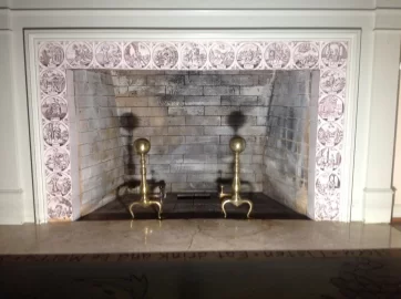

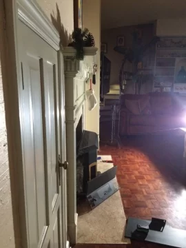

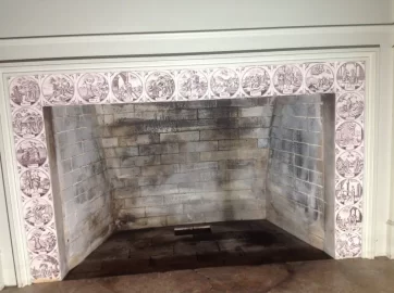

Can you post any pics of the hearth where it will go? Coming off a pellet stove with thermostatic control you may not be ready or want the peak and valley heating characteristics of a stove using tubes for secondary burning and might really appreciate a cat stove's ability to run low and slow in your climate.

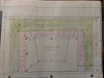

Okay! That was my attempt at uploading photos! I hope that worked. I made a drawing with relevant dimensions. The small door to the left is a wood storage with a steel passthru door to the outside. Currently the steel passthru door is non-opp. Needs repair.
Thanks for the recommendation on the cat-stove...been starting to read up on those. Seems like a better way to go after all. I just hope its not too complicated for the wife to run and wouldnt want it to clog up. We have wet wood lots of times (its oregon after all).
I'm open to doing tile work on the floor, but thats all of the modifications I want to make. Opening the fireplace up is more than I want to get into.

I agree you would need a rear vented free standing stove or an insert that extends onto the hearth. In both cases it's recommended to use a full steel liner to the top of the existing chimney. Most common is a 6" round liner. Do you know what the dimensions and construction of your chimney is? Ex. is it an interior or exterior chimney, is there a clay liner and what size, what's the total estimated length etc.?

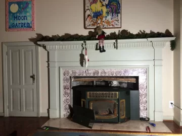

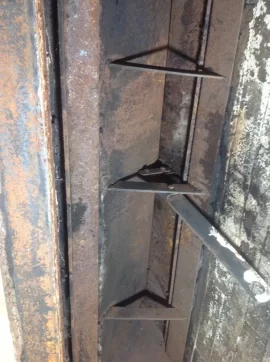

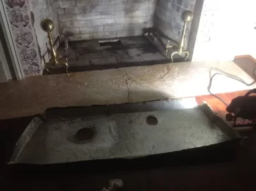

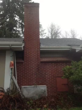

Since we last spoke, I yarded out the pellet stove and measured external chimney at 18-19 feet high.
I pushed the two tubes from the pellet stove up and closed the flue. The flue will have to be cut out in order to fit a 6" pipe through. I want to get up top and look down to find out the internal construction.
It's rusty behind the stove, must be leaking. The 3-4" exhuast tube and fan had 2" of dirt/mud inside.
Theres a draft hole made into the floor of the fireplace with a slide out clean out on the outside.

Progress! Ideally you would install an insulated liner and a block-off plate (see below) to separate the old smoke shelf and flue from the living space for maximum heat retention and performance. Most new EPA stoves seem to require about 15' of chimney so you're good there.

Okay awesome. Need to get creative to get around this flue/smokeshelf or remove it in such a way that it can be reinstalled later. I hate hacking up original parts of the house.
Thanks for the heads up. I will keep my current block off plate. It can probably be reused or at least used as a template for a new one.
That may not doable :). They have top dampers you could add to give that capability back.

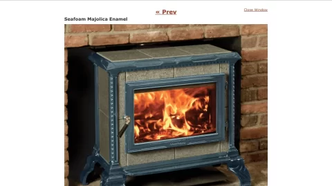

I like the heathstone one and the woodstock one that looks pretty similar and sorta fancy lookin.
Need to lookup to see which are cataylst type
