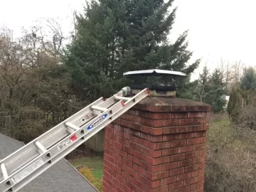

I figured I'd check in with an update. It stopped raining for two days and got up into the 50's with sunshine. I figured the roof was about as dry as it was ever going to get this winter, and it seemed like as good a time as ever to remove the leftover piping from the pellet stove, inspect and install a cap to keep the rain and critters out.

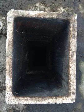

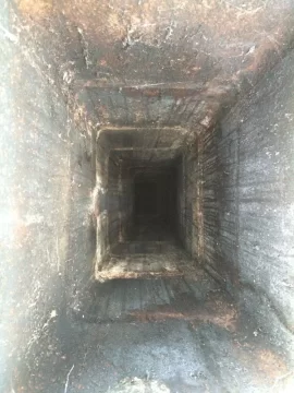

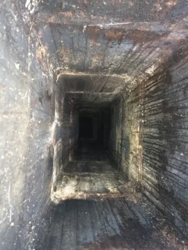

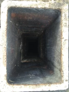

There is not a clay liner inside. The opening of the chimney is 12.5 x 16.5 on the outer dimension. It looks like cement/concrete and it is approx 1 3/16" thick. So subtract 2 3/8" from both aforementioned dimensions for the inside measurements of the chimney.
It looks like it goes down like that for about 2-3 feet and then turns into the same white colored 'bricks' that the rest of the chimney is made of on the inside, but I could be wrong about that.
It is clean in appearance. No visible, at least to me anyway, creosote buildup.
The old tubes and cap from the pellet stove came up easily with a small pry bar to break free the silicone seal.
I went with a 13x18 chimney top that was in stock at homedepot to get the job done today. Eventually I'd like to replace with a stainless steel one, but I needed to get something on there today and it was under $40.
http://www.homedepot.com/p/Master-Flow-13-in-x-18-in-Fixed-Chimney-Cap-CC1318/100072631?keyword=13x18+chimney+cap\
Here are pictures of the internals and the chimney top with the cap on.
With this type of construction am I required to run a SS liner all the way up to the top when I go with a wood stove?
Yes it doesnt matter what the construction is you want a full liner.
Take a closer look at the pictures. It is most certainly not clay. It's made of concrete.
Looks like clay to me. I Could be wrong but it isnt cast in place there are seams. Regardless you need a liner that is way to big to work with a wood stove
Reactions: nellraq
I have never seen anything that looks even remotely like that that is not clay. I guess it could be something regional but it does look like you can see the red of the clay down inside the flue
