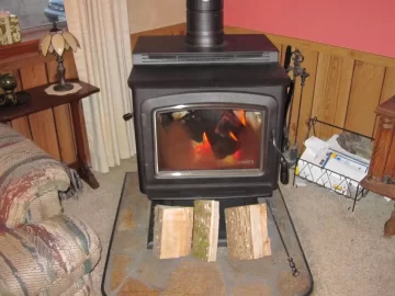

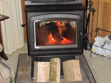

Woodman,
Not sure if its just those pics, but does that stove have amazing clearances?

The clearance is okay but I think the picture makes it a little deceiving.
I believe its the firewood thats touching the stove, but not in the stove, that caught his attention . Bad juju:ZZZ ;)
