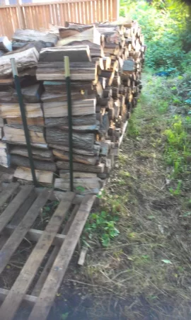

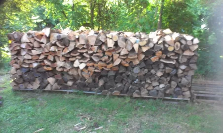

Well the last few months have been very hectic and I decided it is time to re-stack all the firewood. I went the easy route this time. There are still pallets involved though not as many as with my bins therefore I am still Pallet Pete lol.

That's the way I'm doing it for most of my wood, pallets and T posts :)

It needed to be moved so the new fence could go up. I made a mess of our yard and need to restack before the winter hits. We have roughly 12cord to get rearranged this year.

I like the middle posts, separating the long row into manageable (and measurable) units, but I'm surprised those end posts hold.
So far so good I have not had any issues yet. I have been using them for a long time however not on the scale of this year ! In the past maybe 6 or 8 reused a year however this year all my wood is getting put up with them. I buy 6ft posts and drive them in 2ft not much but enough and in the winter up here the ground is so hard you couldn't pull them with a tow truck if your life depended on it.

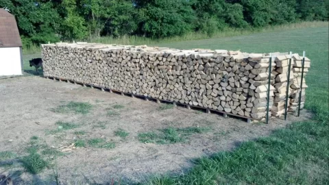

Awesome!
Do you clone you splits? & use a Laser to stack ?
Great picture :)
Dexter regularly puts my level of OCD / anal retentiveness to shame.

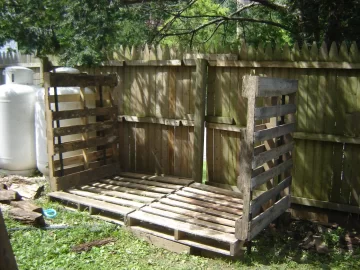

I stack on pallets with T posts too, but slip a pallet over the posts. This makes a much more stable end and requires less precision stacking.
