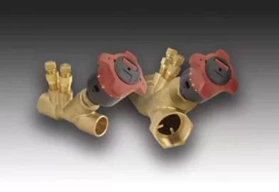

If it is a PITA to set a ball valve correctly would there be any advantage of using a balancing valve like Danfoss recommends. Locally a 1" balancing valve is $60.00 and a ball valve is $15.00 so the cost is not an issue. Below is a picture of the valve I am refering to.
A balancing valve is not capable of responding to variable temps in a system. It is not intended for temperature protection, only restricting flow to a given circuit or device.

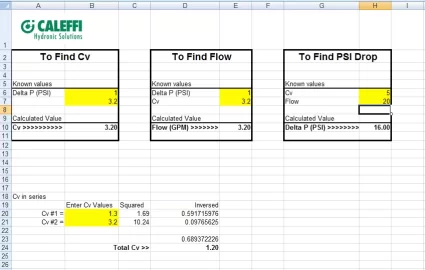

Three way thermostatic are one common choice. You need to look at the spec sheet to properly size one. Valves have a Cv rating, simply the amount of gpm you can flow through the valve with an industry recommended 1 psi pressure drop. Most 3 ways have a 3 Cv, high flow 5 Cv.
Now you can flow more than 5 gpm through a valve, but the pressure drop, or resistence to flow goes up with increased flow. excessive flow can cause wear, and noise problems. We put together an Excel sheet to show how this relationship works. In this example a 5 Cv valve flowing 20 gpm (moving 200,000 BTU/hr perhaps) has a pressure drop of 16 psi. So you can see how pump size jumps up considerable. really thermostatics were designed for DHW applications, not really continous flow at high gpm rates. better brands have larger volutes and cartridges to allow more flow. Large flow thermostatic valves get pretty $$.
