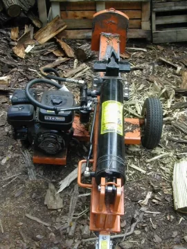

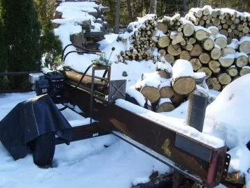

Standing on the other side is even more awkward. Not only is the valve on the other side, but you also have to reach way back as well. Pics below show terrible placement. Best would be dead center, and valve flipped around so lever is closer to ram end.
In left photo, imagine your right calf against piping hot pump, and reaching way over engine to reach valve while trying not to trip over the tire.

Yuck! That is a lousy design. The way I see it, you could simply move the motor forward by drilling new holes for the mount. You could turn the ram 180 degrees and have the lever on the other side and buy longer hoses and a 90 degree fitting for the return line.

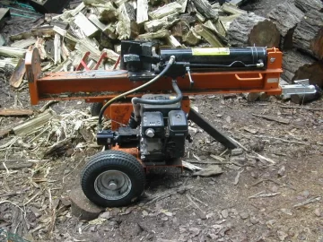

I am right handed and this is where my hydraulic valve is mounted. It is about waist high.
