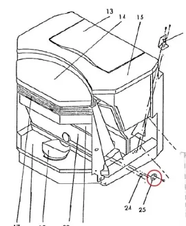

high limit is auto reset. the switch is NC (normally closed) any chance that a wire came undone? here is where its located. You can troubleshoot the switch by connecting the two wires together that go to the switch
