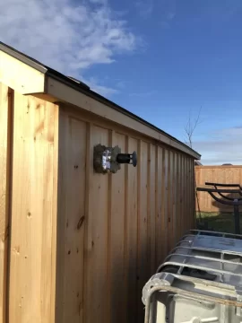

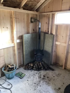

This is what I got so far and it works really good... it seems to be smoking a lot every time I open the door, I’m not sure if there’s something I can do to prevent that?

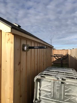

I don’t know if I should the last pipe coming out of the side of the shed or keep it short?

I know it turned out a lot better than I had thought. I need to do a little tweaking so it doesn’t smoke inside but otherwise she’s good to go this winter!!!

Keep in mind you are liable for any fire caused by a non-code install. Your insurance company will also leave you high and dry. Your setup seems cheap until you have an accident, if your shed burns down and burns down someone else's house you are on the hook, if it hurts someone it's gross negligence. Is it really worth the risk?

You do realize just because you saw something on you tube doesn't mean it is even remotely safe right? What do you think will happen when that insulation gets wet? You just have insulation bats leaned against the wall and they aren't far enough out anyway. The pipe is to close to the wall above those "sheilds" you have single wall pipe passing through a wall to outside and no rise outside at all. Just to mention a few that jump out at me to start

I’ll try and find a double wall pipe to send it through the wall and I’ll look into trying to send the pipe up when it gets outside.
The bats on the floor were really good, they kept the wall behind them honestly cold so I like that but the other two will be something I have to look into.
I’ll only be burning wood in there for a hour or two at a time, nothing too long

Put a proper chimney on the stove. This is not a car exhaust.
thank you very much for this, seems like i need around 18inch of clearance. just have to find a 3inch thimble for the wall
If the stove doesn't have tested clearance ratings (because it's an outdoor camping stove for instance), you need 36".
Ask yourself how unhappy you'll be when the shed burns down. If you are passing single wall pipe through wood sheathing with some roxul crammed in the gap, the sheathing is going to pyrolize and catch fire eventually.
That Rockwool insulation keeps everything cold behind it. Not even a little warm but as cold as it gets. My shed is cedar so the outside wood is cold.
I need to figure out how to properly send it through the wall, I might even run this pipe through a double wall 6’ seems like the cheapest way for me. And after that send it up a little past my ridge line of my shed.

Absolutely untrue. R13 is R13. When you compress it and take air out of it like around your pipe, R13 is far less than R13. The airspace is why it is good insulation. Call the number on the bag and ask their tech guys.
You need a thimble to go through the wall.
An electric space heater is $30 and won't burn down your shed. That getup is likely to.
I’m thinking about buying a double walled pipe and putting it thought the wall and running my pipe through the double walled pipe since my pipe is soo small it should be easy. Than sending it up once it is outside
I wouldn't leave sight of the shed when burning and have a fire extinguisher on hand.
What if I do what I say I would do. I think that would be safe.
Put in an actual chimney with a real wall pass through. And some real heat sheilds covering anything within 36" of the stove and 18" of the pipe

hearthon, with the right wind, that "chimney" is going to blow back into your stove, fill your shed with CO, and then when you're unconscious with the stove door open the shed is going to catch fire with you in it. That's the smoking when you open the door -- this is telling you that your chimney isn't functioning. This is no joke. A shed full of wood stove smoke will kill you.

Thank you very much for the article on proper installation, I’ll have to move the chimney above my ridge line on the roof but I don’t think I’ll be able to raise it above the top of my roof. I’ll make it two feet higher but higher then the roof will be tough.
I need something to put it through the wall so I’m going to start researching on how to do that properly.
