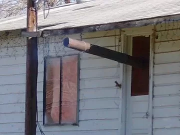

Feel like letting off some steam? Want to tell someone they are crazy or that they are going to burn down there house or endanger their family?
LET IT ALL OUT, ITS ENCOURAGED!

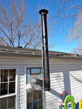

Here is the setup, description first, pics to come.
Vogelzang boxwood stove. Looks like the one in this pic but its the older one that has more air control and no holes in the doors. Its the one with the removable top.
Installed in mobile home--- Store told them its for a shop or garage, not a house or trailer, they said "hold my beer and watch me put this thing in"...
Stove pipe is run vertical from stove, up 2 feet-- elbow then 4 feet thru the wall, out an old window opening, with no doublewall or thimble. Outside is another elbow and from that, 4 feet vertical with a small (too small) chimney cap. Pipe is supported with metal coat hangers outside.
At least it has a floor protector! The stove is 18 inches from the "very combustible paneling" which is subject to say the least.
Want to see the actual "install"? Reply with "yes id like to see this mess...

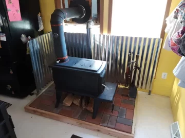

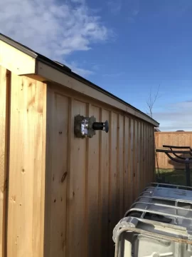

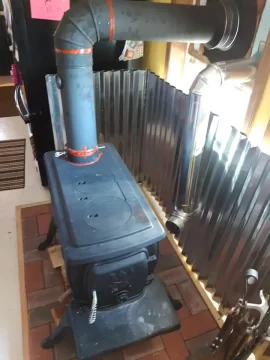

Here is another one for you guys for sale on Facebook

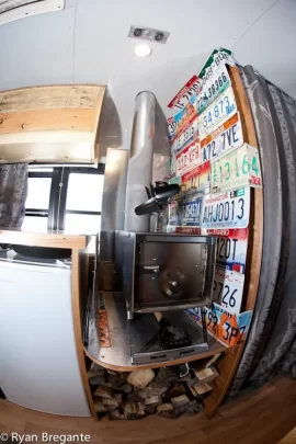

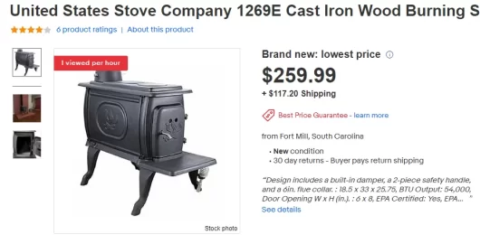

Definitely not to code, but agreed that although it's a temporary setup, it's done with some safety in mind and with a better stove than VG box stove. The RTV on the stovepipe joints is bogus though they probably discovered that with the first fire or two.
Reactions: Isaac Carlson
I would think the interior double wall pipe on the exterior would cause some creosote issues possibly lead to a chimney fire.
I bet 600° RTV silicone has an interesting smell after an hour at 1000°.
It looks remarkably intact in the photos, though, even where they globbed it between the stovetop and the flue collar. Makes me wonder if they have burned it at all yet.
Possibly they posted some "all done" photos of the install and got a hundred "OMG do not light a fire in that thing" responses.... :)
I gotta be honest. While this looks janky and is almost definitely not to code, I'm having trouble seeing it as a death trap.
That off gassing though, they must've bought a case of RTV!
But I find if they simply ignored the manual and those common sense details when they installed it, how attentive of a user do you think they'd be?

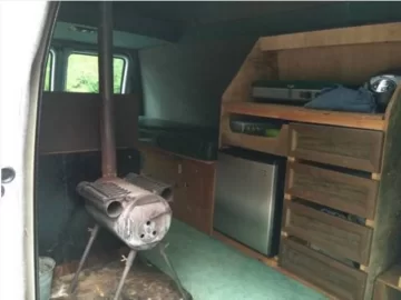

They made a heat shield, considered combustion air. Probably super insulated/tightly constructed home.

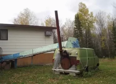

Now the van and out the backdoor pics that’s good stuff!

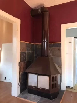

another Quality install

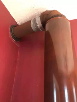

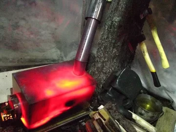

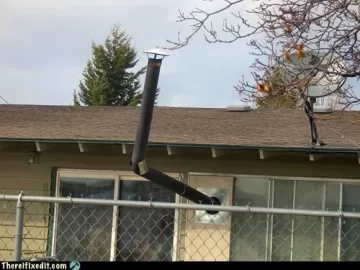

Saw this beauty in a house I was in 2 weeks ago.
[Hearth.com] Bashing this idea is encouraged.. Let me have it!
I actually ordered one of these from Harbor Freight many years ago before i knew what a real wood stove was. When i unpacked it I could see it was poorly constructed with many loose fitting pieces and looked like an overfire accident waiting to happen so i immediately began checking on how to return it . Then i found the disclaimer in the packaging warning NOT to use this stove in a HOUSE or other INHABITED structure. That was the clincher,i packed it up and returned it.

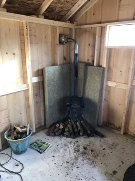

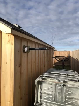

First setup cooks very well, what does every one think? Someone told me to post on this page.
