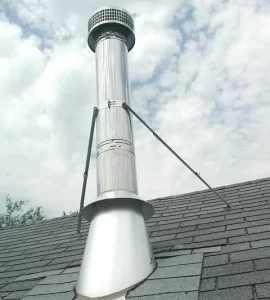

i got the icc one like you guys told me i don't know what you mean by vented but here is a picture tell me what you think i hope i made the right choice

Maybe hearthtools can chime in here, but it has always been my uderstanding that the flashings need to be ventelated at the top, that accomplished a couple of ways, slits in the top of the cone on simpson duravent, and somtimes the cone is buckeld in at te top. The idea is to let hot air that the pipe produces to escape to the outside. I personally havent seen a class a flashing that doesnt have this feature, and it was my understanding that it was code to have such a flashing. I could be wrong, so someone please chime in to correct me.
One more note, most flashings are sold by the size of the pipe, the interior dimension of the pipe. For example a 8" flashing woild have a 10" hole in the case of simpson duravent, now metal fab 8" would have a 11" hole. Different brands have different wall thicknesses. If your not using icc pipe verify that your getting the correct size.
I have never sold ICC, just seen it, it looks like real quality stuff. I can tell you this, 100 bucks for a SS flashing is a bargin, like i said earler, aluminum flashings cost that much. It just raises a red flag to me. A icc dealer need to get on here and verifry you got what you needed.
thanks mike i called the manufacture today in Canada and they told me that my 6 inch a calls would fit the flashing i ordered but like you said it is not vented i hope don reads this message regarding code if my flashing must be vented. i have 2 inch clearance around the plywood where the flashing and the chimney will exit the attic to the outside and i have a ridgvent

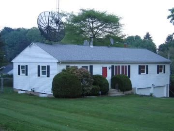

here is a picture of my setup right now it's a 8 inch chimney with aluminum flashing it's all getting taken down and new six inch is going up

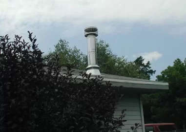

MSG is correct to state that the flashing should be vented . The vented flashing is then covered with the collar that fits the pipe above the vented flashing . My .02 cents
Picture #3 flashing / collar ( note the flashing venting under the collar ) . Picture #4 garage Stainlesssteel chimney .
thanks for the pictures rospike i see the venting if it's code then i will modify mine but if it's not code i will leave it without i know right now both my stoves don't have it now. what brand chimney do you have there? i like the cap also

Metal fab-brand . http://www.mtlfab.com/metalfab/content/view/full/380
Rooster, i would check it out by telephone. it probably just my paranoid self speaking up.. but here it goes. If the flashing is not UL listed for a class A chimney installation, then there is slight concern. And here is why, you are going to take a unlisted produce, modify it to make it like a listed product, which in the end result would still be a modified unlisted product. If you have a house fire elsewear besides the flashing area, the insurance folks are going to cry fowl when they find it in the investigation. Now, lets get back to reality, the chances of that happening are remote, but if it was to happen, it would be a shame to get hosed fot the value of the enire house because of the the flahing installation.
Techicaly, you are supposed tp install a "system". Meaning all metal fab, all simpson dura vent, etc.. to have a fool proof instalation. Maybe ICC is listed not to have vents when there brand of class a is in use, the problem is your not using ICC pipe, i think you know where im going. I would call a ICC back.
Vented flashing are not required.
Only for Mobil home installs or if the Space that the Pipe goes through has no Ventalation.
I only use the standard flashing.
In the past DuraCrap Oh I meant Duravent offered vented and Not vented flashing. Now I see they only have vented (save of Parts to stock)
ICC offers both.
There is always a small air space due to the roof pitch so I don’t see any problems with him using an unventing flashing. And he is using and Insulated pipe and not an air-cooled pipe. Much better for draft.

The venting is put in to help pass the UL tests. It removes heat from the chase allowing lower clearance to combustibles. You have to use the same manufacturer as your pipe to keep the UL Listing and the clearance to combustibles stated in the installation manual. Many people don't, but if you want a UL Listed system, you have to have it set up the same way it was set up for the UL testing.
