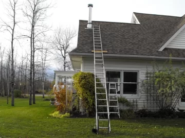

Cleaned it today, just about filled one if the kids sand buckets, maybe one gallon. Fine, dark brown, and dry. Like brown sand. Not a hard job at all and she's ready for this season.

Top down. Everything dumps into the insert.
