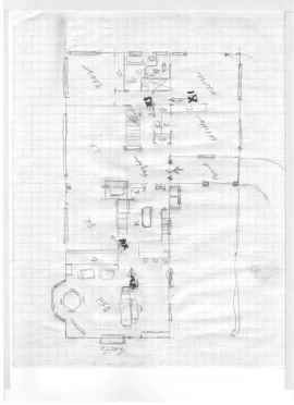

I've been using the small fans on the floor running on low pointed back towards the stove in the far rooms that get the least amount of heat and that's been working okay. But what I tried and seems to work a little better is placing an additional fan closer to the stove room midway to the far room also directed towards the stove at floor level to coax more heat out of the stove room area.
Original fans were at X1 and X2 but adding X3 and X4 have made the cold master bath a lot warmer.

This is interetsing. I have all the back rooms closed off. I am just trying to get 2 adjoining rooms up past 60 degrees. If I succeed with that, I will be more hopeful with your methods. Thx
Except that in order for this to work (blowing cool air toward the heat source) the fans should be place low at the bottom of the doorway in the cooler, denser air.
