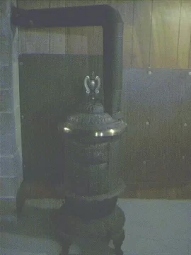

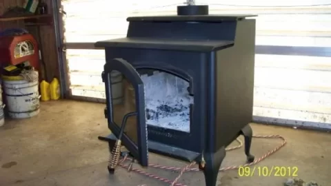

    Hello,
    I've lurked here for awhile but just recently joined. For the past 5 years I've heated my 1600 sf single level home with an old Round Oak stove. I've been questing for a new stove, mostly on Craigslist, for the past summer, mostly looking for Fisher stoves but I just found a QuadraFire 3100 Step Top for nearly the same price most of the Fisher stoves seem to go for.
    The QuadraFire was purchased new in 2006 and looks like it is excellent condition (on the photos anyway). I plan to pick it up Saturday.
    I see variable reviews on the QuadraFire on this site but good for the most part. I think I'll do pretty good with this stove but I do have one question. Will I need a damper in the chimney pipe?
    Does anyone have any advice for a new QuadraFire owner?
    Thanks!
    Josh

    Welcome John. Nice find, that's an excellent heater. It looks to be in great condition. You most likely will not need a stove pipe damper unless the flue system is over 25 ft tall. EPA stoves require more draft than the old RO needs. What are you connecting it to for a chimney?

    My chimney goes straight up through my roof, probably just under 20 feet in total height.

    Sounds like a great setup for the Quad. Check the interior around the corners for cracks and make sure that your baffle above the burn tubes is in decent shape and let that baby BURN.:cool:

    Yes, just about the perfect setup. Be sure your splits are seasoned and dry and the stove will be happy. It'll take awhile to get used to the way the stove burns and how the air controls are regulated. This will be a bit different than running the RO, but I think you'll be a happy and warm camper.

    If it was like my Quad, be moderately careful with the baffle, because it can break.

    Did you feel like this wood stove was a step up from a Round Oak? Do you burn less wood and get more heat? I have a Round Oak 18 inch and I like it a bunch. I like the parlor stove, it doesn't take up a lot of floor space and for an older fellow, having the door up higher is better too. But I often wonder if something like a Fisher would be more effiecent?

    My guess is that you will be on the edge of needing a damper. If your wood is really good and dry, say 15% MC, then I lean more toward you needing the damper (especially since you said that you are concerned about how much wood you use).
    I just installed a Quadra Fire 5700 on a 22-23 foot Class A chimney but with a wall connection and 2 - 45 degree elbows. So maybe my chimney draft is comparable to an 18 footer that goes straight up. So call it about equal on the chimney draft.
    I think where you lean toward not needing a damper is because your firebox is 2 cu ft. Mine is 3 cu ft.
    Without the damper my stove was running 100-150F hotter than my liking at minimum burn rate. Any more air and/or more wood and I was closing in on an overfire. I was going through wood way too quickly to expect an overnight burn. The damper made my stove "purr like a kitten" and "roar like a lion" on my command.
    Even with the damper vertical the stove is much more responsive to the air controls.
    You will know if you need to add one. Cost $3, easy installation.

    The stove has definitely lowered my consumption of wood. It took a couple weeks to figure out the best way to run it but it works great now! So far I haven't needed a damper as the lowest setting keeps a nice low heat. I do have good dry wood and enjoy filling it up in the morning and returning home from work to find a nice coal bed remaining and a fairly warm house.
    It has taken awhile to get used to the heat only coming from the front of the stove rather than all around like the round oak but it works great once you understand how it works. I did not get a blower with the stove.
    All in all this stove has made me quite happy and warm!
