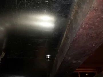

I used magnets to hold my plate in place, you can then use something to seal the edges.
Reactions: Squisher
Welding magnets would hold one up like nothing for securing. Great idea.

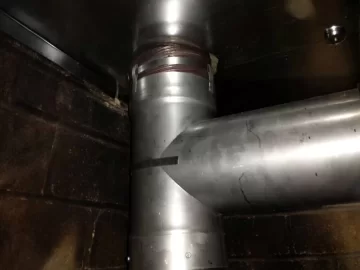

I'm doing the same with magnets. A buddy of mine had some 30 lb strength ones that he gave me and it works perfectly. I can take down if needed without any till tools or hassle.
It's not a great pic but it's all I have to show what I did
[Hearth.com] Roxul used as "block off plate"
