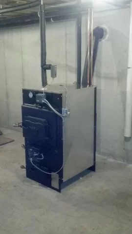

    Better to go smaller rather than bigger with that unit. They do NOT like to idle and will produce incredible amounts of creosote if not run fairly hard. Storage would be highly advisable to help reduce (notice I did not say eliminate) the tar problem. Here's a picture of a 6150 we installed last year for a guy in a 2,500 sq ft full log home. He cannot run the thing unless temps are down to the teens without plugging his chimney every other week. Anything above 20* and it just idles too much.

    Heaterman's observations reflect my experience with a 6150.
