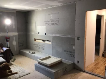

I’ve decided I need to run the cord for my blower down under the house. For my installation the cord going from the stove to the back wall would look tacky. (Seen from many angles) I just don’t want to do all this work putting in a stone wall and pouring my own hearthstones just to have an ugly black cord running to the wall. (And wire tied on a ball under the outlet as I have too much cord)
I have a good crawl space, lots of room and dry so plugging it in down there is not an issue. (Either hard wired in a junction box or to an outlet)
I can either cut the end off the existing cord and run a small diameter metal conduit up through the floor near one of the legs on the stove. Then I can run the cord down to that conduit and wired it up in the crawl space.
my concern in running it through a small conduit is the heat. I know you’re not supposed to run romex through conduit. I’m wondering if passing that sheathed cord through 1/2 conduit will cause heat issues.
The other option would be to run a larger conduit that would allow me to pass the entire plug through it and then plug it in to an outlet in the crawlspace. Obviously the increase size of conduit isnt the best option aesthetically. But I’m wondering if the larger diameter conduit would help alleviate any possible heat issues?
I tried to get some information from Pacific Energy but apparently they don’t return emails.
The conduit would pass through my raised hearth- 2 inch concrete hearthstone, half-inch cement board, half-inch plywood, then there’s an open space of about 9 inches then it would go through the floor into the crawlspace. So I’m guessing the conduit would only need to be about 15-16 inches long.
Here is a picture of what I’m dealing with. The stove will be centered on that bump out part on the right side. (That white thing and the box are the rubber molds for my hearthstone)
That is what the electrical needs to pass through. (Plus 2 inches for the hearthstones)

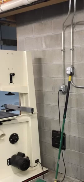

Mine drops down thru the ash dump then thru the block in the basement into a 4X4 box with a switch.
