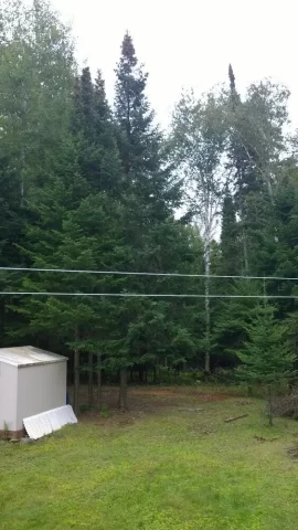

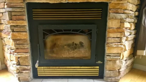

The fireplace is the NZ-26 zero clearance unit: (broken link removed to http://napoleonfireplaces.com/products/nz26-zero-clearance-and-masonry-fireplace/) It has only a 1.7 cu ft firebox and therefore relatively short burn times and moderate heat output. The Regency is a medium unit. Both together are not bad but upgrading the Regency to a large unit (~ 3 cu ft firebox) and burning dry wood will go a long way in giving you enough heat. What kind of chimney does the Regency stove have?
Rotten wood is a sign of bad drying conditions. The wood should be split, raised from the ground, top-covered, and be located in a spot where it gets maximum sun and wind. This here is about ideal: http://cdn.instructables.com/FXC/BDTJ/HJ605MEM/FXCBDTJHJ605MEM.LARGE.jpg Not everyone has the yard to do all of it but the closer you can get the better.

Interesting. Why do so many people build woodsheds then if (while it makes sense) sun exposure is such a useful factor in drying wood?
To put it in there after it has been dried out so it stays dry and snow free during the winter. Some are also built to allow good air circulation. With enough time that will dry out the wood even without a lot of sun exposure. Aside from that, there are many people who still believe wood can be burned the day it is split.

How hot do the rooms with the stove/fireplace get? Could you post a floorplan (rough sketch)? I am not saying you should not get a boiler but I wanted to point out that there may be other, cheaper solutions to your problem. It is up to you what to do with that info.

Wood sheds are nice so you don't have to tarp wood in the rainy season or dig it out of the ice and snow. wind / air circulation is a bigger factor in drying than the sun.
