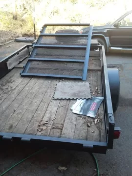

I have a small travel trailer that has some rust spots starting on frame.
POR 15 seems very labor intensive. Almost as bad as sanding and repainting
Thank you all for your replies. I have decided to wash well,sand to bare metal, degrease, prime with rust inhibitor primer, lightly sand full frame, then top coat with oil based paint. The rust is not extensive but want to work against it now. If I see it returning within two years then POR 15 is on my to do.
