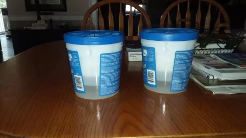

also helps to put a container or 2 of damp rid in the fall.
you can see the water it accumulated in 6 months.
this was 1 in the burnpot and 1 below in the ashpan.
