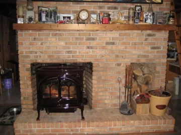

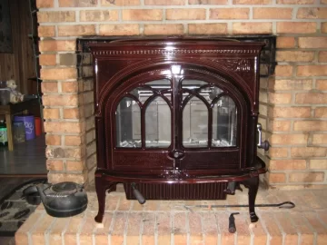

As someone who has a stove in my basement level and another on the main living level of our home I'd like to second Sprinter's comment on the basement as being a poor choice to place a stove if you are hoping to heat 3000 sq. ft. It is very difficult to move a great deal of heat from a basement to upstairs with that much space. If you are burning 24/7 you will have the best chance of getting some significant heat upstairs, but if you are going to firing up only part time, then I'd say you are going to be disappoint with most any stove you select.
As per the stoves you mentioned, I put in a Jotul F600 last February in our living room and we are very pleased with its performance. We had a cool spring, so I got to do a fair amount of burning, but we didn't have any extended sub-freezing cold snaps to see what the stove can really do.
