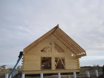

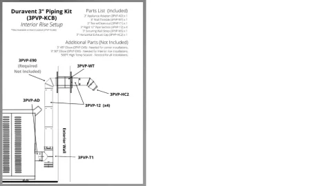

Hey guys, been a long time lurker 1st time poster. We are looking at the PP130 PelPro stove and were going to direct vent out the side
under a large porch. I was confident in the install until seeing a lot of people having soot problems inside and out (more worried about inside soot).
We will have the rise inside then horizonal out (over 18"). I have attached diagram of what we were gonna do. I also have attached a pic of our house
when it was being built and where they pipe would approx come out (dont have recent pic). Let me know if you guys think it will be an issue.

First do not vent under the porch you will have to go past the outside edge
I have used a pellet stove for 22 years starting my 23rd season have never had a soot
problem . If it is installed right and all pipes sealed you are good to go
Think I'd go straight up and vent out the roof if the stove is on the first floor.
I presume the pillars are for the porch support. You should not vent under the porch floor
I know my insurance company would not like it Fire hazard. Welcome to the Forum
View attachment 299244 View attachment 299245

This is what I would want to do, just have to get the right components from Duravent. I would have to go from 3 to 4 due to length i assume.

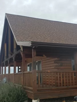

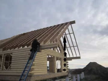

Here is a picture of the finished house. I am trying to figure out a way to do this. A few questions. Does my chimney have to go above ridge? The stove only says 12" above roof. There is a ridge vent that im worries about. Do I need a ceiling box even thought its not going through attic? Any help is greatly appreciated

I am not a chimney expert, and have zero pellet stove experience. However I believe the 2-3-10 rule holds as well here, meaning the cap needs to be at least 3 ft above the roof penetration, and 2 ft higher than anything within 10 ft.
Also, if you are below the ridge, downdrafts may happen due to wind curving down after coming over the ridge. While a pellet stove has forced airflow (fans) I think you still would want to avoid downdrafts. But maybe I'm wrong in this.
I'm not sure about the ceiling box if the pipe is going thru the eves; it's class A and keeping clearances from the combustible roof materials may be enough.
Ceiling boxes are meant to accommodate the transition from stove pipe to class A (and keep clearances, and support the heavy class A so it doesn't mean on the stove pipe and stove).
Sorry for the uncertainty; as I said I'm not the expert.
@bholler?
But I should congratulate you on the amazingly beautiful home!

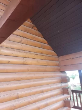

I recommend, before cutting any holes, talk to people that do this for a living, use inspectipedia on the web,etc. You most certainly can vent a pellet stove under that wide open porch, just the same as you could a direct vent gas heater. The only issue would be "ground" protection, as the deck is wood, you would need a bit of non flammable base put down, unless your vent is high enough. Look in any Harman manual online, they have real good diagrams about such. Soot is almost never a problem, unless the stove is not functioning properly, as happens with cheaper stoves, OR, a possibility in your case, if that porch faces in the direction of the prevailing wind, in heating season. That would be the only reason I would not vent there, because if the wind blows straight into that porch, you will even get smells in house every time door is opened.

Just a roof is not semi-enclosed, it is just an extended eave. Perhaps i is different up your way. But is why I recommended he get more info.
I think "under the porch" is under the roof but above the deck - hence the "ground protection" (non combustible floor protector).
Indeed, under the deck is something that is not safe. Best to be able to see the exhaust.
Yes,I think there is a bit of misinfo or misunderstanding here. I see no basement, so he would be coming out underneath the extended eave,or porch roof. However, he could never enclose it, even with screen or shades.
