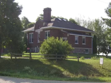

here's the thing. i just bought a home, an old one room school house, and i just love it but i have noticed that even though i have the house set to 60 the LP furnace runs just about all the time! and it's only been between 40-50 degrees around here. i can only imagine what it will be like when winter hits!
the square footage is about 2,400. the first floor(technically is the basement) is finished and has 2 bedrooms a family room and 9-10ish ft ceilings
the second floor (the main floor) has the kitchen/dining area, living room, and master bed. pretty open has 13-14ish ft ceilings
the loft is well just that a loft lol
here's the problem. first the furnace almost never shuts off(the atic is insulated.... could use more that's a project from this winter, the floor form teh basement to the main is no insulated, also i can't really do anything about the main floor exterior walls). second the thermostat is in the living room which is a southern exposure and is lined with large windows so the room warms up and the thermostat shuts off the furnace causing the basement to become quiet brisk.
thirdly i love wood heat been around it my whole life so it's really a no brainer on getting a stove but where to put, and will it do what i want (heat all the floors) is the question.
there is a large existing masonry chimney in school now that looks in good condition from what i can tell. i'm guessing i would have to put a new pipe in for the new modern day stoves. it goes all the way to the basement.
i am wondering and hoping if a wood stove/pellet stove (leaning to wood majorly) might do the trick of heating the home... the problem is that the only real spot for it is in the basement in the family room. and from what i have read the basement isn't a great spot for the stove...
i guess I'm just wondering what do you guys and gals think would work best for heating the house, all floors get used. a wood furnace add on is not really an option since there is no room at all in the furnace room so that's out...
just looking for help about where i should look what i should do what size stuff like that. the local stove dealers really aren't much help. any and all input and help is greatly appreciated!
-Neal

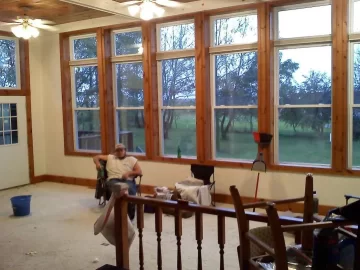

included are some pics to hopefully make sense of what im talking about. (dont mind the mess i was ripping off wallpaper and painting when some of these picks were taken)
  • [Hearth.com] school house need help heating!

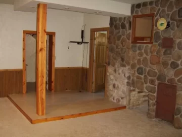

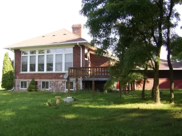

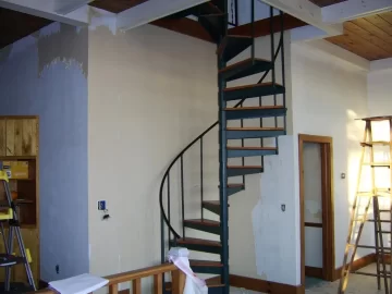

Is that 2400 sq ft total or for each floor?
It doesn't look like you have a good avenue for heat to flow upstairs so trying to heat everything with 1 stove might be a real challenge even for the big boys. If each floor is 1200 sq ft. you might consider a medium sized stove for each floor.
Welcome, first of all...that's a great house.
Usually I wouldn't recommend a wood stove to anyone that doesn't have their own source of wood. But with so many windows I suppose you're better off with wood than than letting all that high priced fossil warmth out the window. You can probably stack 10 cord under that deck too. Hopefully there's a room by the chimney on the main floor you can have a pro thimble into and enjoy a nice full standing stove.
I don't think you be as happy with a pellet stove in that house.
I think I would put a big wood stove in the basement with a new pipe running up the old chimney. Try to get some distance between the stove and the fireplace, so there is plenty of room to radiate heat. The stove should at least keep the lower floor nice and warm, and probably help with the upstairs since the floor is not insultated. I am sure it would be better to have a way to move air from the bottom floor upstairs, so perhaps there is a way to add grates or registers into the floor? A stove on the bottom floor seems like the easiest installation, and I think will have a much better chance of heating both floors than a stove on the upper floor (which would not heat the lower floor much at all). Sombody else suggested two stoves, which I am sure would work better if they were both running, but with two you'd have twice as much effort to keep them burning, and/or you'd have to start twice as many fires. Also, you'd have to figure out how to install a flu pipe into the chimney on the upper floor, which I guess would mean cutting into the stone chimney. I think if it was me I'd go witht he easier installation on the lower floor and count on the wood stove providing some of the heat for the house, but probably not all.
Greetings Neal. Getting a stove set up in the 1st basement floor should help a lot this winter if you can obtain several cords of dry wood now. That is going to be the crux of the issue. If not, the results may be disappointing regardless of stove.
The first step is to have the current flue inspected by a certified sweep. You'll want to get a status report on its current condition, construction, and tile liner size. Is this chimney on the interior or exterior of the bldg.? It looks like the stair opening is large enough to move a lot of heat upstairs. How close is the flue outlet to the spiral staircase opening? If the flue looks good this could be as simple as dropping a liner down it and connecting it to a good sized (3 cu ft) stove. If you can post a floorplan sketch of both floors we can review for heating circulations issues and solutions.
The other issue that will need to be addressed over the long term is heat loss. Have you considered insulated panels or curtains for the large glass area? Even with thermopane windows that represents a lot of heat loss. Wall and ceiling insulation should also help a lot. Maybe talk to someone about the option of having some blown in the walls upstairs?
Wood stove downstairs, pellet stove upstairs? You can vent the pellet stove through the wall if you don't have a second flue in the chimney. That way you have your main heat (and any wood mess) downstairs with the pellet stove as supplemental heat upstairs.

Gotta be 2 or 3 flues in that chimney - only 1 serving the LP burner. So you oughta have 2 more to play with. I'd be thinking of two stoves - prob a couple big'ns. One in the basement, one on the main floor. You'll prob find you can run only one of them most of the time, but will enjoy having them both.
And as noted by savage above - you gotta have your cut, split, stacked, seasoned & dry wood supply squared away if you're gonna think of this working well for you.
Any chance that large property could house an OWB for you?
And what's the LP system running - forced air? hot water baseboards?
I will second (or third or whatever) the idea of getting the flue inspected, drop down a liner (insulated if possible) and slam a big 'ol stove in the basement of that thing. I would be looking at the 3+ cu ft range. Uninsulated brick walls are COLD.
Very cool house. While a wood add on furnace may be out because of the restrictions you mentioned, you could put a boiler wherever you want and use a water to air exchanger in the furnace. You could take care of hot water with this setup as well. At some point, you could add radiant floors in those big open spaces and zone them separately.
Folks in the boiler room who do this might have some ideas for you.

Don't know what your money situation is, but if you are on a budget I would do the windows first. The combination of the high ceilings and all that glass make it very hard for any heating unit to work. If the windows are not insulated, do that first. Add ceiling fans second and then think about a stove. At some point those naked brick and plaster walls will need to be insulated. Great house, but it is a heating nightmare without attention to keeping it in.
What an awesome house!! Jealous here! I second that motion on the windows. Do windows in 09 (tax rebate) and Stove in 10 (tax rebate!) Or vicey versey!

I'd echo Danno's sentiments strongly on the windows thing - except the pix make it look like all the windows are vinyl replacements already :( save up to replace those in 10 yrs.

Your second pic shows a fireplace AND an adjacent thimble/crock cover, looking like there was a direct-vent stove hookup in the past into an adjacent flue. So there's at least 2 flues. But it's a huge chimney - wouldn't shock me if there's 3 total, w/ the LPG occupying one of them. and you need to measure the open "fireplace" there to see if you could put in floor protection (assuming that's not a slab there? gets easier/cheaper for you if it is) and a hearth stove w/ a rear connection to a cleanout-T (makes future liner cleaning a LOT easier that way).

The first thing I'd do is slam a BK King in the basement and then look for simple ways to actively move the air upstairs. You have access to wood, so start using it ASAP.
The next thing I'd do is go find a lot of bubble wrap (the small bubble variety) and use it to cover as many of the windows as you can tolerate covering. Do this by cutting the bubble wrap to fit the glass panes. Spray/mist the windows with water and place the bubble wrap on the window with the bubbles facing the glass (a little soap in the water helps if it doesn't want to stick). This might sound crazy, but adding the bubble wrap over the glass as I suggested will increase the R value of the windows by at least R1, yet still let that nice sunlight in for solar gain. It might not look as good, but when you have that much glass, increasing the R value by even R1 will make a huge impact!

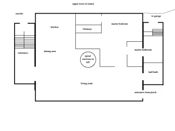

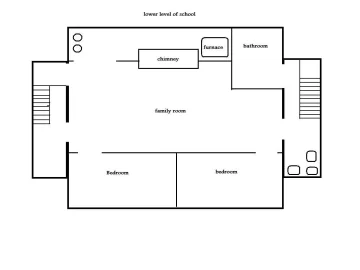

here are the rough sketch's of the school.
Equinox in the living room downstairs with pipe running straight up out through the 'house'
If there are 3 flues, looks like a stove per floor to me.
