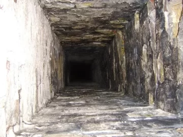

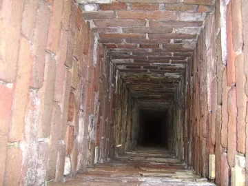

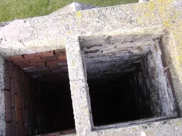

the chimney actaully has 2 flues one which looks like it hasn't been used in ages and another that has definately been used recently
the flue that was used recently is larger... i can't say by how much becuase like a moron i forgot to bring up a tape measure.... but it more square than the unused flue.
even if the cimney didn't NEED a liner. i'm thinking that i will have to get one anyway cause even though i'm looking at an equnox i'm sure that is just way to much chimney for a wood stove.... but then again it does look like it was used recently.....
any ideas, i'm thinking a need to get a chimney inspector and see what he says.... i'm sure though cause it doesn't look clay lined to meet code it will have to either get clay lined or get a smaller flue installed, which when i got estimates for that was just crazy expensive.
what do you guys think? just want some opinions.... if chimney is ok will it be too much draft? too much down draft? i'm looking up a chimney inspector tomarrow.... should i look under chimney sweeps? anything else you can think of that i missed?

The flue(s) will require a liner, but the good news is that they appear to be in decent shape. The left one looks unused.
The usage of these chimneys will be different from yesteryear. Back then there were fire drills and no one was living in the school 24/7. The occupation of the building might be the complete opposite with it being empty from 8-5, with a woodstove heating, instead of a busy school during these hours.
