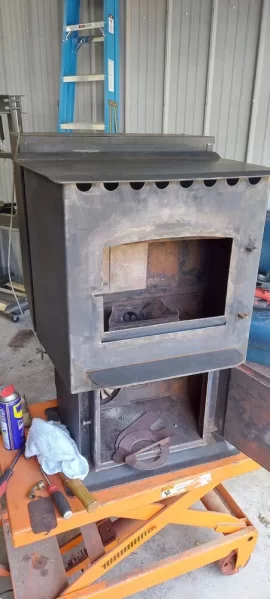

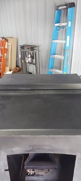

Not that I'm a pellet stove expert, but I've had a few stoves including two Harman Pf100s. I'm familiar with how they work and confident I can fix them. I saw an ad on craigslist that said "Harman Stove". It was in unknown condition and the seller wanted it gone with an asking price of $200. We quickly got on the road and drove the 1.5 hours to check it out. I didn't know the model number yet, but for the money I couldn't pass it up, regardless of what it was. We arrived, the owner had a tractor and loaded it into the truck. When I got it home, I started tearing into it, here are a few quick shots of the exterior:

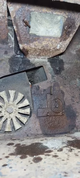

The stove looked rough from the outside, the inside was worse. I've never seen something so bad. I had to pry the latch up to open this housing:

Check out the cleanout under the burn pot:

The sawdust had solidified, I had to chisel it out with a pry bar and hammer.

Sounds like a good way to learn this thing inside and out. Hopefully there are no rust holes in the heat exchanger.
WOW, I’ve done a few Harman stoves that were rough…that one looks like it sat in water…I’ll be following…I might be able to help with any questions too…

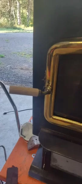

That's what I wondered too! The electronics look great though. I'll get some pictures showing how well the wire wheel worked out. Biggest project will be building the broken door handle. I'm not paying $100 for a screw and a handle.

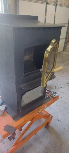

Here are some updated pictures after wire wheeling. I also rebuilt the door handle. I was lucky that the foot was still on the threaded shaft. I drilled out the broken threaded shaft and rethreaded for 3/8 16 which is what the stock piece seemed to be. After some welding, grinding drilling and sanding the handle is rebuilt and good as new.

Well, the paint finally arrived. I'm really impressed with the Stove Bright brand. Yes, it's expensive at about $20 per can. I used about 1.5 cans in the repaint. Can't argue with the results though, in my opinion it came out really nice (hard to screw up flat black). After the paint dried I fired the stove up and reassembled. Looking forward to many years of use, thanks for following along on my rebuild.
