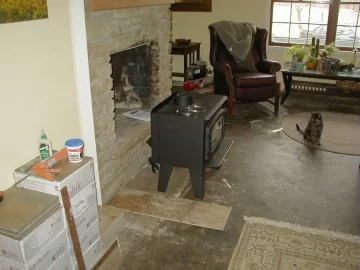

Ok, I know you guys are sick of me but I'm man enough to admit I fu$$ed up. I'm like that sometimes (as in there must be a workaround).
To refresh your memory photo is attached of the disaster.
SO --
Need a new stove and trying to avoid an insert, would appreciate your recommendations.
** The distance between the back of the said new stove and the center of the chimney pipe adapter is 18".
** That chimney pipe center is 38" (bottom of adapter) from the floor (floor where the stove will sit).
So, based on that, do you think I can get good draw out of a rear vent stove? (chimney is in a single story ranch, stainless steel liner and well insulated). Obviously, I'll have to come out of rear vent for 18" into a 90 degree elbow and up.

The Buck 261 is a rear-exit, steel stove that could handle this setup. If you can keep a steepish pitch on the horiz. run then there are a number of other cast iron stoves that would work. But getting down to EPA and $1500 just killed all but the smaller stoves. How large an area is being heated?

The Osburn 1100 is an insert. It is not for use outside of a fireplace. You might check on the Avalon Rainier-45 to see if you can purchase it with legs. But dmmoss51 is correct. If the chimney is part of the issue you may still be swimming upstream against the current. (Scratch this idea, the chimney is a big part of the problem.)

As I said in the first posting, an insert is the best possible choice here having the greatest chance of success. Given the short chimney I would put in a PE Super insert. It projects nicely into the room and is a good convective heater even with the blower off. Or consider a Regency Hearth Heater or a Hearthstone Homestead.

You're right, it's like a smaller Rainier-45. I checked Woodland direct, but they list it as an insert. Regardless, with a short chimney, horiz. run and a 90 deg turn, this thing is going to draft poorly. Straight up from an easy breathing insert is a much better solution.

Each mentioned item is adding resistance to the smoke path. Modern stoves need sufficient draft to pull the air through their secondary manifold. Some stoves need more than others. With poor draft an EPA stove heats poorly because the secondary burn is weak or nonexistent. You are starting out at a disadvantage with a shorter chimney. Adding 90 deg turns and a horiz. run is just adding insult to injury.
Get a decent sized, easy breathing insert that has good hearth projection and be happy.

Right now the stove is protruding completely into the room. To be honest it doesn't look great at all. If you want good heating, especially during power outages, the protrusion works much better at convecting heat without the blower. But there are totally flush inserts on the market if that is what you like. Take a look at the Osburn Matrix and the Regency Alterra for examples.
