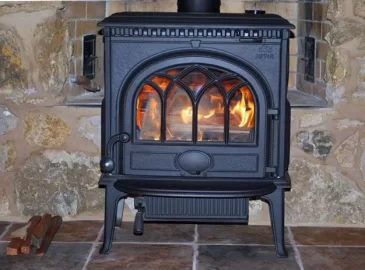

I've spent a lot of time looking at the forum gallery this morning and seeing photos like the one attached.
Either very small stoves completely in a fireplace or outside of it like the Jotul shown, yet I'm told it can't be done.
Also, I'm now leaning toward having my wood heating source more supplemental than primary and a stove that is more decorative (love the wide look of the Jotul or Vermont castings).
Looking at the photo I attached, my situation is even better than this -- my chimney adapter feeding the flex chimney is much higher but need the 18" horizontal run (which I bet is happening with this photo and others I've seen).

Who said it can't be done and why? Plenty people have hearth stoves. Your fireplace opening height sounds like you could install a small Jotul in front or slightly inside. You may have to extend your hearth to make the front clearance requirements.

I don't know of any Jotul that requires an 8" chimney and I believe VC only requires 8" for open screen burning option.
So if it has an 8" outlet I could use a reducer without a problem? I won't say that others told me I couldn't do it but I was under the impression it wasn't a good idea.
As I said, if I put a rear vent stove in front of the fireplace I would have to go 18" horizontal to a 90 elbow, then up.
Depending on the stove's outlet height, I could possibly have more of an incline rather than completely horizontal.
It should state in the VC manual what size flue is required. I believe VC has an oval to round adapter for their stoves. 18" horizontal run should be fine as long as it has a slight rise to your 90 elbow.
