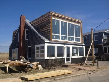

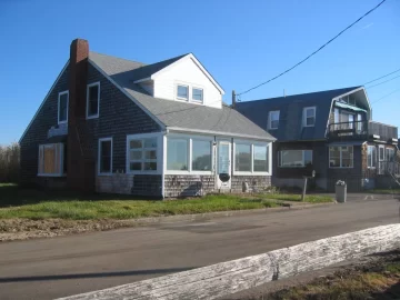

my update:i'm new to this, but am interested in going as far away from oil/electric heat as possible. my cape cod 2 storey house (2 floors x 900sf=1800sf total with 7'/8' ceiling heights and open stair connecting the 2 floors) was severely damaged during hurricane sandy. it's on the bay and took on 2' of water inon the ground floor so i'm taking the opportunity to reevaluate my heating and lifestyle. back up heat will be electric baseboard because it's the least expensive installation and i hope to never use it.
i prefer modern or authentic reproduction with a view of the flames. any advice would be greatly appreciated. so far my research has taken me to the following options, but i'm open to suggestions comments....
1. morso 2B, one on each floor (i like the look as it was originally designed about the time my house was built) $900ea
2. bosca limit 450 on ground floor plus an ecosmart fire bowl for looks on the second floor (i like the loof of the bosca, clean and modern, but relatively quiet design) $1029 @ home depot
3. pacific energy fusion on ground floor plus an ecosmart fire bowl for looks on the second floor(looks acceptable but can get it for $2000 in stainless steel)
4 englander 17vl, one on each floor (looks fine, least costly $450ea @ home depot)
so i know what i like visually, but don't have any experience as to the day to day practicalities nor their efficiencies etc.in order of preference: looks, performance, cost effectiveness over time.

post-sandy pic of current renovation. i still need to raise the house min 2'6" and the chimney flue as well. i'll most likely locate the main stove and reuse the hearth....

and a pic/floor plan
Seems one stove on the main floor with at least a 2.0 cu. ft. firebox would be adequate but you could go up to 3.0 cu. ft. if desired. Look for a stove that will go overnight. I go 10-12 hrs. with the T-5 which is a 2.0 cu. ft. stove and the Fusion should do the same. I can't speak for the other stoves but there are many good stoves to choose from. I suggest you get your wood supply now, cut, split and stacked off the ground and in the wind.. Get ash, cherry and maple and you might be able to get by for next year but you need to do this ASAP..
Good Luck!
Ray
