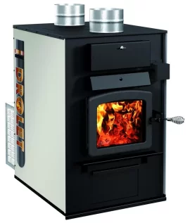

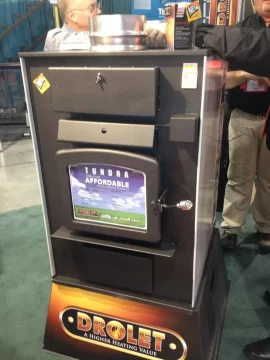

    If it was me I would install the Drolet Tundra downstairs when it becomes available in August . Finally a wood furnace with a window and secondary combustion.

    There's actually several of these out there, but this is a nice looking unit!
