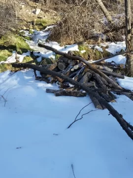

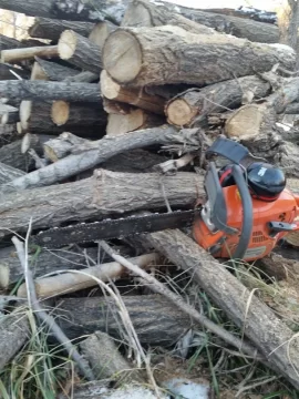

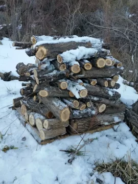

i had the day off yesterday, so i got rid of some of my piles. This was the scrounge from when they were doing tree work for the utility company. I still have to cut a bit shorter and split it, but at least it is off the ground!

This pile is a bit older, but by the time I cleaned up the majority of the scrounge, I didn't get around to cutting up very much of it.[Hearth.com] Seasoning in piles
