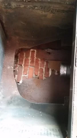

The damper gets removed or cut to clear the liner. If an insert is put in the gas gets capped off or removed.
The damper does get removed but that is some sort of heat form and usually some of the back wall will need to be removed in order to fit a standard 6inch liner thru without pinching it from bending it into a s shape.
Similar to this. Just make sure to follow manufactures instructions and clearance requirements. If you have to remove the entire heatform by cutting it into managable pieces and rebuild a firebox before installing an insert.
  • [Hearth.com] Second Opinions - Wood Insert and Cast Iron Fireplace
You dont nessecarily have to rebuild anything as long as there is enough masonry left to meet code.
