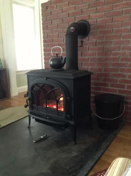

I am sorry if this has been covered before but I am new to the forum and am very frustrated with my wood stove. Just over a year ago my parents gave me their old Jotul 500. That had it refurbished, great stove for them, just wanted to give it to me to have a great stove in my home. Has been a great stove up until a month ago, when I now have just not been able to get the burn it used to get, especially when it comes to the secondary burn. I used to (just a month ago) be able to get the stove going and completely shut the dampener down and the flames would roll in the top over the wood and would burn for hours. Now I get the stove going and shut it down and the fire dies.
I have cleaned out the stove completely. I have had the chimney cleaned (chimney and flue are new to the house, about three years old). I have tried to contact dealers and ask them questions and have done everything they have told me to do or try with no luck. Now a dealer is saying to try the dollar bill trick. Does that make sense? Wouldn't I have an out of control fire if that were the case, not one that would completely die off?
Well any thoughts would be greatly appreciated. I have loved this stove up until now, but very frustrating to not be able to get it to do what it has done in the past. Thanks.
Ben

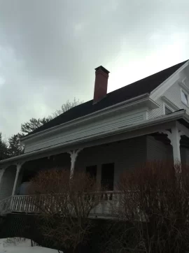

Not sure if there is a flue cap screen or not. Just has a stone cap as the picture shows. They cleaned from the clean-out in the basement, not sure about the baffle but no soot was left in the clean-out or where the stovepipe enters the chimney.
As for the temp that I shut down the stove, I would let the stove get hot and a good fire going first (anywhere from 300-400 degrees). Shut the doors and would watch it come back down a bit, and would either have to finesse it a bit more or it would drop down below 300 and then start climbing on it's own, at which point I could close the dampener down all the way and I could walk away for hours before coming back to reload. Or it would get going right away and I could shut it down.

Nice house.
