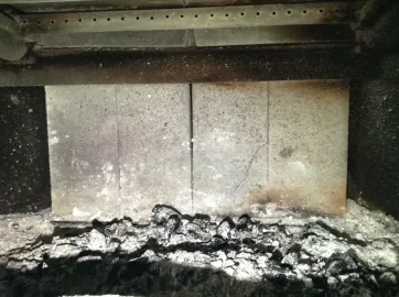

I have not yet tried dried wood from the store yet, sorry. I have, however, discovered something inside the stove that seems like it should not be that way. There are two plates that sit on top of the tubes (sorry for the bad description), and one of them seems to be warped somehow. The left plate (upper left corner) seems like it just does not want to sit right on top of the tubes. Maybe you can see it from the picture. I have tried to see if something is stopping it from sitting properly but there is nothing, it just seems bent somehow. Could this be my problem? Someone mentioned the baffles sitting properly. Are these baffles? Could this have gotten bent somehow by heat? Thanks for the help.

I'm not a stove expert, but from my experience it looks OK to me.
It can get ugly in there after years of burning...that's the nature of the beast. If your burning seasoned wood without smoke chugging out of the chimney that epa stove/tubes are doing its job.
I briefly checked out the other link you posted and imo if the stove wont do a dampered down burn like it use to...then it's always the wood that's the blame.
Besides that it's your parents stove...they just wouldn't have given you junk.
If it were me in you shoes determined to burn I would split what had into smaller splits and burn hotter.
The plates are the baffle. I think this is the old style. It's important that the flame path wrap around the front of the baffle and not leak past the baffle. The plates should lay flat so this is worth looking into. You can pull the top off the stove by removing the few shipping bolts that hold it down.
