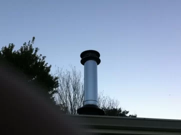

I snapped a pic on my way to the chicken coop a few days ago. It was within 15 minutes of a reload, bypass closed and the T-Stat on 2.
