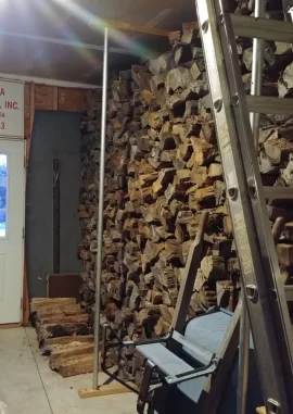

Attached is my inside garage setup. 1-1/2 conduit secured at the top and bottom with 2x4s, drilled to match the conduit. Cement anchor to the floor. Drill the ceiling so the conduit can be raised then pulled out for summer. Wire run between to keep from bowing out. 3cord storage, then free to use for the lawn tractors etc, then back to wood again in Sept. Check my avatar, a similar setup outside but with fence posts on the ends.
