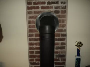

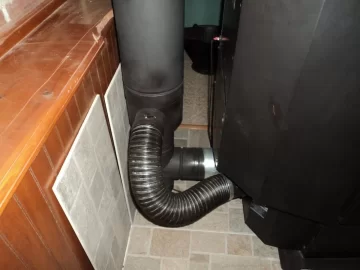

[Hearth.com] Selkirk DT [Hearth.com] Selkirk DT Here is my set-up. I'm going thru a masonry chimney, but yours would be basically the same. I have to mix and match the different Selkirk venting to get what I need. If you call Selkirk they can help you.
