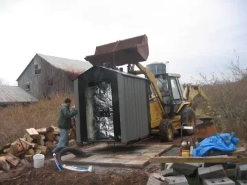

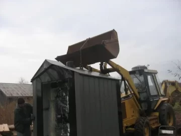

That is certainly one way. I got mine off a different way. My buddy had his Cat backhoe over at my house. He simply raised the bucket over the OWB. We put some heavy chains around the bucket and hooked it on to the eye loop on top of the OWB. He only had about a foot clearance off the truck bed - which was plenty. He plopped it down right in the exact spot within two minutes!
(BTW - it is a big Cat with a bucket that can reach up 13 feet and handle a two ton load).
Here's pictures of the Cat putting the OWB down on the platform. In one of the pics, you can see some large black pipes with blue and red pipes sticking out coming out of the platform. These are the PEX pipes used to circulate the hot water. It is easier to thread them under the OWB while it is airbourn, then after it gets plopped down. This is because the PEX tubing does not bend well and it may be hard to get the tubing through the bottom of the OWB. Have the Cat driver back the OWB up a bit and raise it up as high as he can. Then thread the pipes into the OWB floor. Then have the Cat driver inch forward while you pull the PEX tubing through all the way. If the OWB is already in place and you can not get the pipe through ahead of time, you will have to cut the PEX tubing off and splice it together again with Sharkbite couplings.
BTW - I have two black pipes going into the OWB. One is for heating my home/hot water. The other goes to my hot tub. :0)
Cheers!

Shoe, Did you have to cut the bottom out as well to accept the pex? Also, what size Cat is that? My buddy has a 416 and I'm trying to check if it could handle the lift.
No, I didn't have to cut any holes in the bottom. Mine has two square plates - one on each side - that are held down with self tapping screws. I just removed the screws and the holes were there. I did, however, have to make one of the holes a bit larger, since I thread two pipes into the bottom on one side. To do so, I simply used a recipricating saw with a metal cutting blade. It took about three minutes cut make the hole larger. No big deal. Good luck!
I'm not sure if my buddies Cat is a 416, but I have seen Cat 416's before and I am sure it will work out fine. Make sure your chain is capable of lifting the heavy weight!
