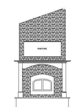

I have been splitting wood like crazy. We had 5 large dead oak trees (died maybe a year or two ago due to root damage) on the property that needed to come down anyway. I had a small amount of seasoned wood too, from a few years ago. So no....I probably am short on good seasoned wood but I'll make do. I will post pics of my Quad once I get it all done. I am taking this ledgestone tile to the ceiling and also building a black walnut surround and mantel from wood that my dad has been keeping for around 60 years, just waiting on a project. This seemed like a good use of that walnut to him so I am working on planing it down and making it usable. This is a jpg I took from the drawing I design everything with so you can get a rough idea of my final product.
