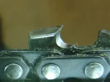

I am sure all chains still call for a 10 degree tilt this helps to clean out the gullets.
You can clearly see the 10 degrees here.
if you say so, but I think it looks like 11 maybe 12 degrees.
lol.

smokinjay said:
oldspark said:
The reasoned I asked is when I first bouth my 045 (1979) it called for the 10 degree angle but since then I do not remember ever seeing one of my Stihl chains calling for it.
Well thats interesting, not doubting you but I have the info for my chains and will look later.
Danno77 said:
lol.
i hand file and who know what degrees I'm doing.... All I know is that it cuts better right after I've gone through it.
lol the 10degree tilt is the part of the cutter that clears the chips....without it your still going to cut but your cutter will clug up quicker and need to file more offten. Not a big deal for the weekend guy. I just like my chains to be perfect fast and when milling very smooooth. (a lot goes into a great chain)
