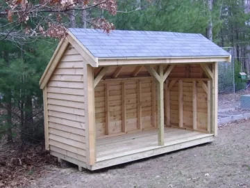

I'll be building a dual purpose shed -- it will house the lawn mower and snowblower and about a cord of seasoned wood. Additional wood will be stacked on racks nearby for further seasoning. Maybe an 8x10 footprint...still working on that. :)
Sizing depends, in part, on where we put it on the property...
Another member uploaded the shed image below, on the "Show us your shed" thread. I'm thinking of something like this, with one side closed off for the mower & blower, etc, and the other side open for wood. I'll have a dividing wall between the two...
The rear of the shed will likely take the prevailing winds (and rain), unless it goes in "spot b", in which case the front will take the weather (and that would suggest that I'd have a door on both sides.
I'd appreciate input on siding options -- I could do tongue & groove cedar or 2x8 pressure treated...or something else. The floor and supports will all be pressure treated. Open to suggestions...
The "garage side will be watertight, with ventilation. On the wood side, I would like some airflow, but with the wind and rain coming from the rear, I'm not sure how open I want it...I can leave a gap between boards on the side, but not sure I want gaps on the back. Wood in the shed will go almost directly into the stove, so I have to keep it dry...
I'll have more roof to the rear, with a shorter downslope on the front. For my last shed, I did a traditional asphalt shingle roof; thinking about metal this time around. Pros/cons appreciated...
I expect to be using this shed for the next 25 years, so I don't mind overbuilding it. :)

Use metal, you will not be disappointed. It's all I use anymore, and 8x10 you should be able to get away with minimal cutting for the short slope on the "front." IMO, use metal for the siding as well. Goes up super fast. I would probably leave an air gap between the top of the wall and the roof if it were me to give some air flow. Just overhang the roof enough that you're not going to get water in there. Unless your "Spot B" has some awesome location advantage I would go with "Spot A" since it sounds like having the wood dry is a top priority.

Thanks...I've done some reading on metal roofing. Roofers use a different system than what I can find at the Big Box stores and the latter requires some maintenance once in a while -- replacing fasteners and gaskets. Might just stick with asphalt...I built a shed at our current house 25 years ago and it still has the original roof...seems that great ventilation allows the shingles to last longer (versus shingles on a house roof).
And metal siding wouldn't fit in...this will need to blend in with traditional clapboard and shingle covered houses on Cape Cod. I might even shingle the sides to match our house, if the sides show (depends on the positioning of the shed). Or clapboard the front, if it faces the same way as the house. :)

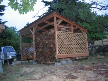

Make it twice as large as you think you need or you may be adding on in a few years. My preference for the sides is that they be ventilated by using staggered slats, lattice, trellis, or other method that allows good air circulation through the stacked wood.

And I'm thinking through the staggered slats idea...I've seen a number of sheds on the shed thread with air gaps and I think this is probably the way to go on the wood storage side... I'll play around with roof overhangs to see if I can get sufficient coverage.

I put a corrugated metal roof on the wood shed. It's far enough from the house that noise is a non-issue. The key change I would have made (and need to) is making the back of the pile accessible. Too often in a year like this one we have wood left over in the shed that needs to be moved out so that the newer wood can be stacked in back, then the super dry older wood goes in front. That's nuts. Unfortunately I nailed up the lattice with ring-shank stainless nails so pulling them is going to be a bit of a chore. I will definitely switch to screws for holding back panels in.
Agree on access from both sides, and make it bigger than you think. Mine is 8x36 and I should've done 10x40. Also I skipped the siding and went with 20" overhang on all sides... rain never touches the wood, and only an occasional light dusting of snow in the winter along the bottom foot or so when it drifts. Seems well worth the ventilation.
