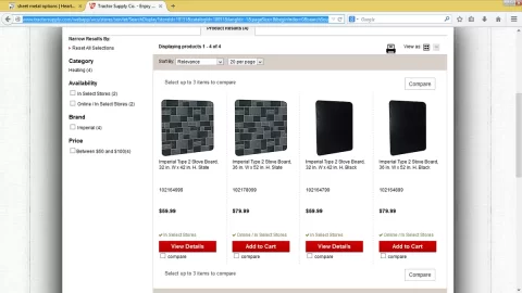

How about something like one of these? http://www.tractorsupply.com/webapp...Id=10051&storeId=10151&searchTerm=stove+board
