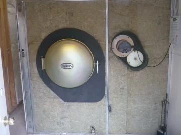

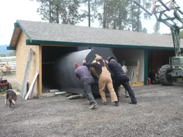

I think a container would be a great boiler shed especially a reefer, would be totally insulated. A Garn 1500 and up would be a little to big unless you could get access to front ,back and top. I built my shed 10 x 20 put the garn tight to one side after everything was done I have about a 16 in alley to get to the back.
Pics

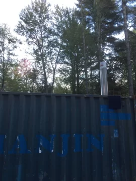

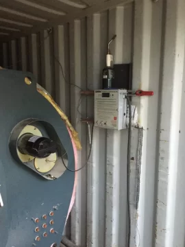

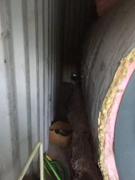

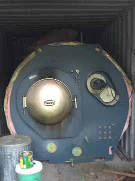

I will try to get you a few pics of my install tomorrow ( think mine was the one Buzz saw was referring too). I tried to search for my previous posts that had photos, didn't have much luck... Anyways, I have a garn 2000 in a 20 shipping container. It was intended to be temporary for last year to get me up and running until I could get my garage built that would perminately house the boiler, but things happen, days fly by and it is still in the container... I really liked the set-up last heating season. It kept me dry while starting the boiler, offered some space for wood /kindling storage and most important, it was a quick easy solution to get my system up and running last year.
Pictures as promised. Kind of crude, but it actually worked better than I expected. If I was to do it over again, and the setup was going to be perminant I would have gone to a 40 foot container (more room for wood storage). Unit was a little snug but I left it about 3 feet off the back wall to allow access to the piping connections and combustion air. Didn't pipe the inlet duct out of the container as the top corners are ventilated, so if figured there was plenty of air draw into the container for combustion. I ended up with about 16" of space Down the left side between the wall and boiler. Would have liked a little more room while I was running the piping but... I piped the supply and return back up to the front side of the boiler before turning back, this allowed space for tees to install the supply/return sensors and a set of isolation valve before connecting to the thermopex at the rear of the container. All in all the set-up worked pretty good. No issues with condensation on the walls. I think it would be an excellent alternative to a stick built barn for a fraction of the cost.
