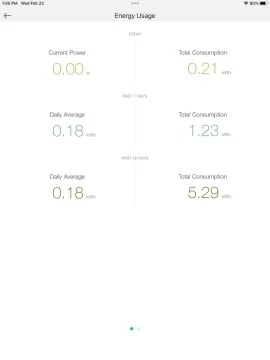

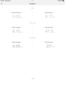

My BK stove didn’t come with snap disk. Instead I put the blower fan on a wifi smart plug. Now I can tell Alexa to turn on or off the fan. Before bed I tell Alexa to turn on the blower for ex: 6hrs, etc. Once i figured out my stove’s heating pattern I have a good idea of how long to run the fan. It’s not as easy as a snap disc but it’s better than nothing. The plug also monitors usage stats, not that fans are expensive to operate. Our kWh hour rate here is about .14 cents, so the past 30 days cost roughly .75 cents to operate.
