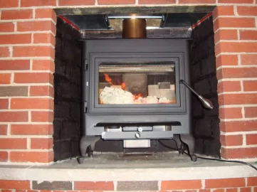

How much heat is "lost" by being absorbed by the brick? My sexy Englander 13 stove sits in a masonry fireplace, and I use an IR gun to record temps of 225 degrees F on the surface of the fireplace's black inside brick, while recording temps of 580 on the flue collar.
The bricks remain warm even after the stove cools down. I have a pedestal fan which blows into the fireplace and removes some of that heat.
I have a block-off plate, Roxul insulation above that plate, 15 feet of insulated liner running through my masonry chimney, a Roxul-insulated smoke shelf, and Roxul below the top plate. Outside with the IR gun, I measure no difference between air temperature and chimney brick temps. So, no heat loss.
Just wondering if I should add a layer of Roxul against the fireplace sides and back and then "seal" it with 3 metal sheets from Home Depot. Would that prevent the fireplace bricks from absorbing heat, and thus, allow more heat to radiate out immediately? Again, I don't detect a single degree of difference in the outside chimney walls vs. the outside air temp. I am not losing heat through the outside chimney. When it snows, the entire chimney stays dusted with snow even as a fire rages.
Not complaining....just wondering about increasing efficiency. All thoughts welcome!

You may get heat quicker but you will loose the heat retention of the bricks. Nevertheless, I don't see how it could hurt but when you don't notice any heat loss on the outside it may be just a waste of your time.
Thanks Grisu- that makes sense. No need messing with it then.
@mellow: Thanks for your reply. I came across your original "insulation" thread when I was still lurking here- before I signed up. It got me thinking....
So I followed your nice write-up and checked the chimney temps several times over several days over different stages of the fires. No temp difference. So I guess the inside fireplace brick walls soak up some heat, but that heat is later released inside the house- not outside. :)
