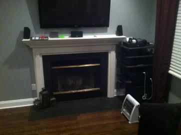

Below is a picture of the fireplace. If I do in fact get an insert, yes I will be addressing the haphazard electronic placement I did. Also, no space heater jokes -.-

If that's all wood around the fireplace opening, I'm afraid that, no matter what you decide is feasible heater-wise, all that wood is in jeopardy of having to be removed. Welcome to Hearth.com! Rick
yea its all garbage trim. i do plan on tiling, moving the tv up a tad, and changing the mantle. We just bought the house about 2 years ago. Forced hot air + Cathedral ceiling room where the tstat is = my gas meter is at risk of taking off its spinning so fast.

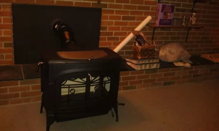

can you create a hearth pad (taking out some of the wood floor) and install a free standing rear vented wood stove (as has been already mentioned)? Here is a photo of my setup to give you an idea. I don't have a hearth because the floor is concrete....

If you don't mind the stove taking up room I would go with a free standing stove extended outwards from the fireplace imo. But It gets pretty dang hot above the stove and that whole area may become off limits to putting a television and having expensive electronic equipment near by. The radius 1-3 feet around my stove especially above it (where your TV is) is frequently >100. Of course electronics should be able to handle that but I still worry about it...
