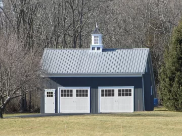

So, my carriage barn renovation continues, and it's time to think about siding choices. Here's a photo with the new doors I have chosen PhotoShop'd in place:

Plan is to house wrap over this old vertical 1x12 spruce siding, fur out the wall, and install new wood siding. Timberframe construction favors vertical furring, and thus horizontal siding, but anything is possible with some work.
I did consider masonry siding (eg. Hardiboard), but the weight made it a less than ideal option for this structure. I won't consider vinyl or any metal siding. This is an old barn, next to an old house, it shall remain wood.
Welcoming any ideas for siding type, installation, and even paint scheme. Current paint color matches shutters and trim on house, so it is a nice tie-in. However, new doors cannot be painted this siding color, and so will have to remain white if we go with the same color again.
Hate to say it but I like the board and batten on that type structure. A lot of wok for the same look. I think other choices will make it look modern.
No problem. All opinions are valid! I've never been entirely satisfied that board and batten is weathertight, but given my air space / drainage plane construction plan, that may not be a show stopper. How do you case windows and doors with b&b siding?
What about ship lap (I don't object to board and batten, either)? I love shingles (shakes?) and clapboards but they're labor intensive and that means money; money you may not wish to spend on an "outbuilding". My brother used masonry siding on his barn. It was expensive but it looks fabulous... you would never know it was "concrete". Our barn is shingled. And it's stained with bleaching oil and silver grey stain. I wanted it to be red, but rather than "get into it" with the good man I acquiesced. Since 2007 he's warmed up to the notion of red... when it's time to address it we'll discuss it again. ;)
I would try to minimize the man door by painting it to blend in with the body of the building. To my eye, it looks kind of awkward next to the new garage doors (which I like very much!)
