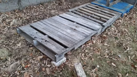

After years of stacking firewood on a variety of different things, I finally found that pallets are the best to stack on.
It took a little longer to figure out that a pallet between two rows tends to keep them from falling over.
Finally I came up with this design, which doesn't cost me anymore than a box of screws and time.

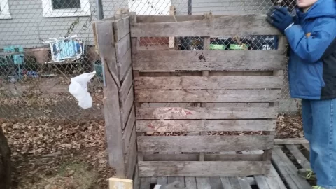

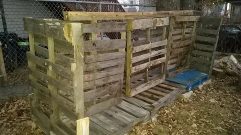

I start with three pallets in a row, sitting on bricks or blocks, but only supported on the front and back.
[Hearth.com] Simple pallet firewood rack
Each end gets an end pallet so I don't have to do any cross stacking.
My kids and friends can stack for me without any issues this way.

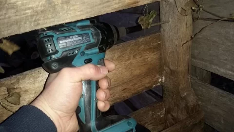

Now drive screws diagonally through the ends of the vertical pallet members into the base pallet center member.

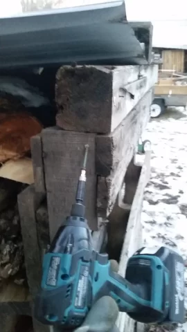

I happen to have a collection of 4x4 timbers from Craigslist for free, but this part could be done with more lumber from broken up pallets.
I screwed the 4x4 to the divider pallet, and use it to anchor a divider pallet on the middle pallet .

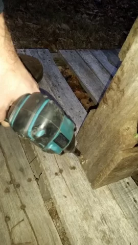

I cut a 4x4 to fit the top of each end pallet, and screwed it to the top of the pallet

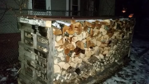

Loaded and seasoning

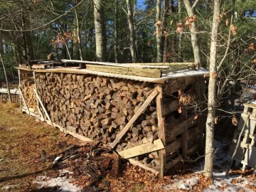

Next seasons wood .
I've built two of these now, but have plans to make enough for three seasons

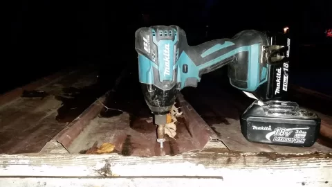

It is hard to tell from your pictures but it could be you are using philips head screws. I have transitioned over to star or Torex screws. They are many times easier to drive, they literally will kill your drill before they cam out.
(broken link removed)
Actually they are the torx head screws, 2 1/2" long.
I still managed to shear one off yesterday with my Makita impact, that thing is a beast!
I had some left from building a swing set for my kids.
Never going back to Phillips if I can help it.

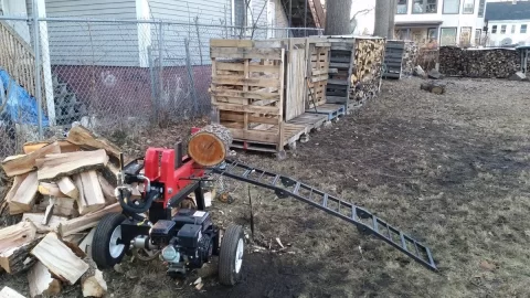

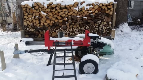

[Hearth.com] Simple pallet firewood rack Added another rack to the end of the last one yesterday

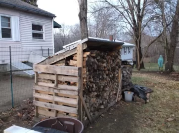

Nice, very similar to what I built. Mine has a sloping roof with roll roofing.
Also I used a nail gun rather than screws, I think it is a bit quicker.;)

A nail gun is faster , I like screws because they make it easier to remove parts as they rot or break.

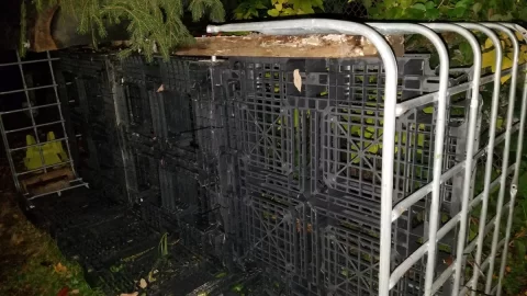

I get the 230 gallon totes for free from work.
I use the tank, but didn't have a use for the cage.
Cut the cage in half

Bent poles are inserted into holes in the plastic pallets I picked up free
